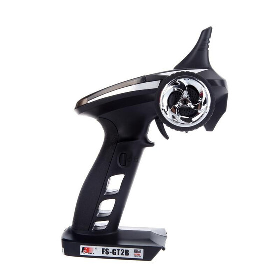

radio car rc:
fr.aliexpress.com %2316062%23490

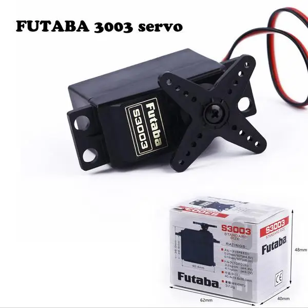

servo standart /
